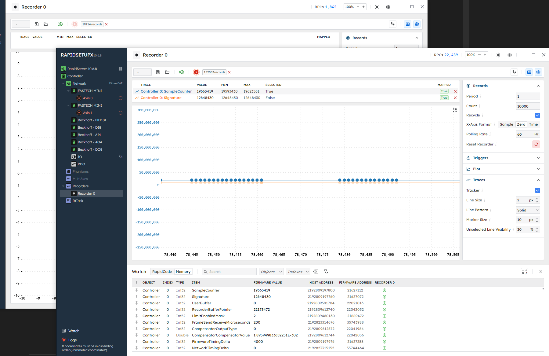

But the main issue seems to be that RapidSetupX is automatically trying to read your recorder data, and it’s polling all 7 recorders. In testing with two instances of RapidSetupX running, we observed that the second instance intermittently “steals” data records, resulting in incomplete data sets, as shown below:
This is unintended behavior, and we are prioritizing a fix to address it. In the meantime, we recommend avoiding running RapidSetupX while recorders are active to prevent data conflicts. Thank you for bringing this to our attention, and we’ll provide updates on the resolution soon.

The issue here stems from RapidSetupX performing an unintended operation. Regardless of whether one or multiple recorders are active, RapidSetupX currently attempts to fetch data from them simultaneously with your application, causing potential data conflicts and overwhelming the server

The issue:
This behavior lacks additional verification to determine how the recorder was triggered. Specifically, we should distinguish between motion triggers initiated via the RapidSetupX UI versus those initiated externally (e.g., through RapidCode or another application). The missing logic here is what leads to the unintended plotting or data highjacking.
