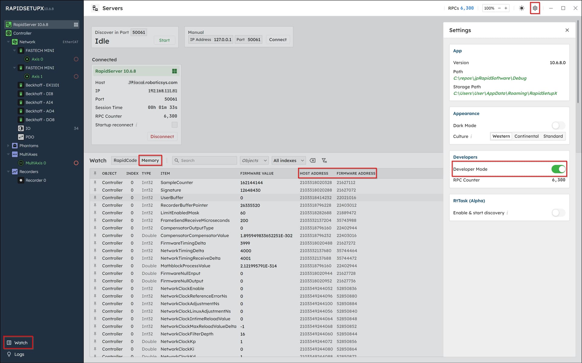

How can I watch/scope user buffers in RapidSetupX?
On a related note, how can I watch/scope an arbitrary firmware address?
And, how can I get a host/firmware address for something visible in the watch window?
Currently, we only allow Memory items to be scoped.
You can view UserBuffer in the Watch window by selecting the Memory option. To see the host and firmware addresses next to each item, enable Developer Mode.

The given UserBuffer address is for UserBuffer[0]. Theoretically you could calculate the offset, knowing that they are byte addresses and 32-bit (4-byte) registers.
