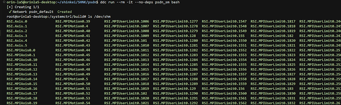

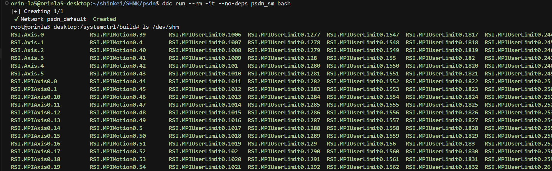

We see that the /dev/shm is mounted in our container.

An update from our side - we managed to have our client sw connect from within a container by having both firmware + client containers use the host process namespace.
