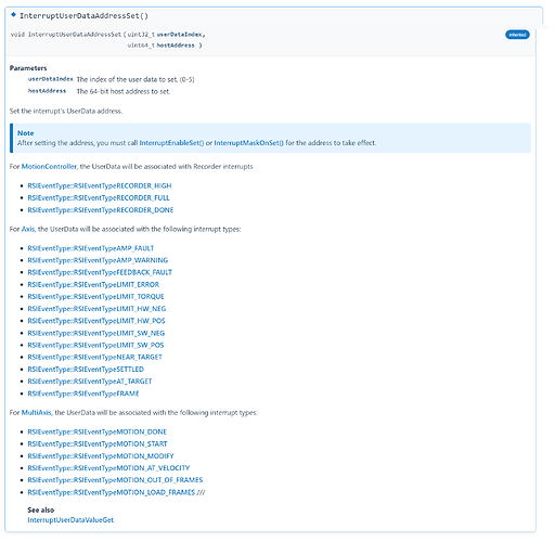

Good questions. At present the RapidCode API only gives you programmable access to the Interrupt UserData for UserLimits with MotionController::UserLimitInterruptUserDataAddressSet().
In theory, each type of Interrupt supports up to five unique UserData values, so we’ll need to add the RapidCode API to allow you to specify the UserData addresses for various interrupt types. How’s that sound?

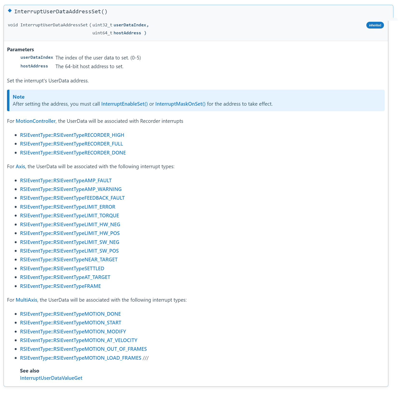

Yes, exactly. Something like this:

It’ll be released with 10.5.4. No release date set yet, let us know if you want it scheduled soon.
This feature was released in 10.5.4 on July 10, 2024.
