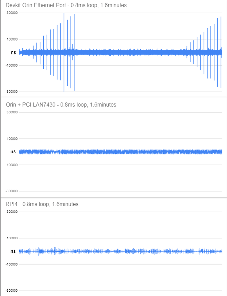

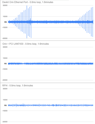

It sounds like you’ve got NIC driver/PCIe/performance issues. Rather than trying to work this out on a boat, I’ll see if we can come up with some simpler code to test the NIC latency, outside of RMP and EtherCAT.
This NVIDIA forum post has some similarities:

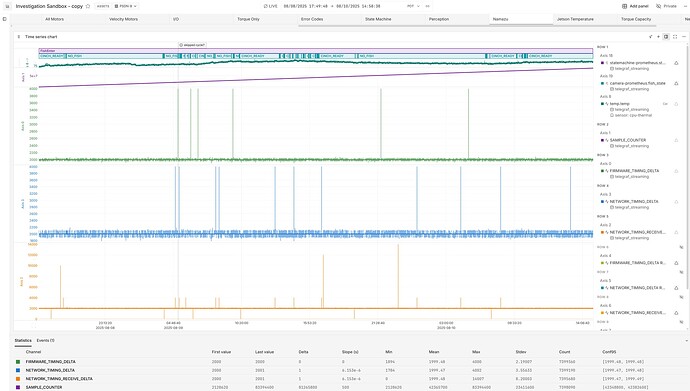

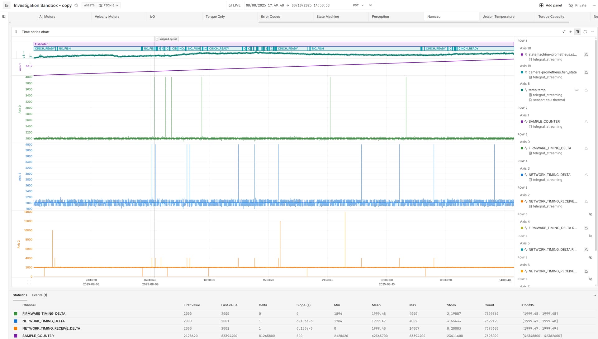

These logs output the motioncontrollers self-reported min and max network timing deltas & processor usage (ignore the ms, its us and the target is 1000 us)
I’ve also noticed that, when running cyclictest at a priority higher than our motion controller rt prio, we see that cyclictest is usually pretty stable but when run at a priority lower than our motion controller, the max recorded latencies spike along with the motion controller (as expected?) to 1000s of microseconds. This confirms some constraint mem, IRQ, NIC, is blocking the process rather than some other process consuming time on the core.
Referring back to the Ubuntu real-time kernel tuning blog Scott mentioned earlier, it seems you can add additional options to your grub boot parameters to specify a set of CPUs for housekeeping tasks to run on: kthread_cpus=0,1 irqaffinity=0,1, preventing them from running on the cores where the network and other crucial tasks are running. You can verify that no interrupts are running on certain cores using watch -n1 -d "cat /proc/interrupts". The guide also specifies some other boot parameters you could try and see if they help, such as isolcpus=domain,managed_irq,5.
Also, is the debug data you sent (with the stats on the network’s timing deltas and processor usage) collected with the network running in parallel with other processes like the perception task or the ntp time server synchronization via starlink, or is it running in isolation (just the RMP MotionController running in its container)? If not, I’d be curious to see what the numbers are with the MotionController running by itself.
With regards to the cyclictest latency spikes when run at priorities lower than the MotionController, we expect the latency to increase since the MotionController’s threads will take precedence over the cyclictest threads. However, I don’t expect the latency spikes to exceed a millisecond due to the MotionController’s execution. If you run cyclictest at the lowered priorities but without the MotionController running, do you still see the same spikes?
@shota we can try a few of those boot parameters. The difficult thing about this failure mode is that it can take up to 44 hours to occur. Or could be as little as a few minutes. Jitter looks really good most of the time over those 44 hours. When taking data points every 20ms, Stdev for FIRMWARE_TIMIT_DELTA is 2.19. We do see some spikes that don’t seem to be causing failures. And interestingly, NetworkTimingMaxGet() isn’t catching these spikes that we are recording with RSIControllerAddressTypeFIRMWARE_TIMING_DELTA
I was hoping that reducing sample rate from 1000hz to 500hz would resolve the issue, but we are still seeing network crashes.
Another data point I want to add, I am seeing evidence that RMP “Processor Usage” percentage can be affected by IO usage. Video linked below. We are normally sitting at ~35% usage but when I start a test with fio, The usage spikes up to ~58%. I am wondering if we should be seeing a distinct error if that usage goes over 100%, or would we just see IsNetworkOperational() return false, as we are currently seeing?

The 14 millisecond NETWORK_TIMING_DELTA shown in the screenshot your earlier post is pretty concerning. After some discussion, we decided to write a small network utility to get some timing metrics on the underlying system calls that RMPNetwork uses. We’ll get you a source file and some instructions on how to compile tomorrow.
The RMPNetwork receive thread is actually the highest priority thread we create, higher than the RMP firmware’s threads, so if it is being starved then it may cause the lower priority threads in the RMP to also miss their timings, which is likely the source of the “RMP is dead” message. We think that message is merely symptomatic of the latencies RMPNetwork is experiencing.
We haven’t observed latencies this large on our in-house systems (both x86 and ARM systems) or on other Linux customers’ systems before, so we’re still searching for additional configuration options that your specific hardware might need.
I’ve sent both @edco and @rickys an email with a source file for the network timing utility along with some instructions on compilation and usage. We plan to eventually put it on GitHub in a public repo, but for now we’ve emailed the current version of it with the subject line “Linux Socket Performance Utility”. I’ve pasted the contents of the email below.
The command to compile the utility is:
g++ -o nicperformance--std=c++20 main.cpp.
It sends some EtherCAT discovery broadcast packets on the specified NIC, so you will have to run the utility with at least one EtherCAT node plugged in. Also, the code uses raw sockets and sets things like CPU affinity and thread priorities, so it will be easiest to run the program with sudo unless you explicitly give the executable the required capabilities (which might be doable with setcap cap_net_raw,cap_net_admin,cap_sys_nice=eip if I remember all the capabilities correctly). The program outputs the mean and the maximum latencies on sending and receiving the discovery packets in microseconds.
You’ll have to specify which NIC you want the utility to use with the argument --nic=<nic_name>. You can also specify some other configuration settings if you’d like:
