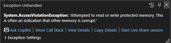

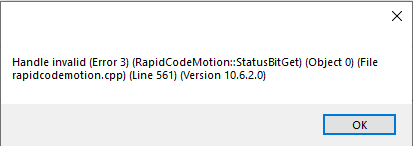

When INtime and my application software start for the first time, and under this condition we execute the touch probe routine, issuing a velocity move command like axis2.MoveVelocity(-0.5, 20.0), we encounter the following error:
In this condition when we restart our software without restarting INtime, and run the same routine again the error vanishes. Can someone shed some light on why something like this could occur?
This is the routine for the touch probe. Note that the error is always observed for the API call done inside the “try” block only. Also note that when we restart the application software alone after the error has occured, and run the same routine, we do not get the error.

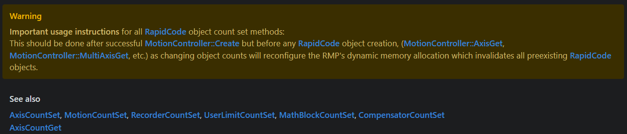

// Some Necessary Pre User Limit Configuration
controller.AxisCountSet(3);
controller.UserLimitCountSet(1); // Set the amount of UserLimits that you want to use.
controller.InterruptEnableSet(true); // Enable User Limit Interrupts. (When a user limit input comparison is met, and interrupt is triggered)
